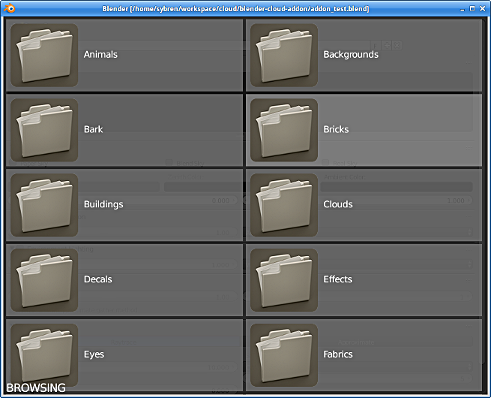

Browsing texture folders

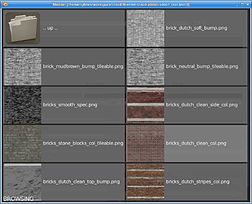

Browsing textures
Browsing textures
